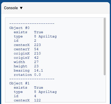

Visualización de datos#
Printing the tuple returned by get_data displays a list of all properties of all detected objects:
# Display properties of all detected AprilTag IDs
while True:
    vision_data = robot.vision.get_data(ALL_TAGS)
    if vision_data[0].exists:
        break
    wait(0.25, SECONDS)
print(vision_data)
Captura de pantalla de la ventana de la consola que muestra la salida de depuración para los ID de AprilTag detectados. El texto enumera 'Objeto n.° 0' con campos como exists: True, type: AprilTag ID, id: 2, centerX: 223, centerY: 54, originX: 210, originY: 42, width: 27, height: 23, bearing: 14.1 y rotation: 0.0, seguido de una línea separadora y el comienzo de 'Objeto n.° 1' con exists: True, type: AprilTag ID, id: 4 y centerX: 122.

# Display if an AprilTag ID or AI Classification
# is detected
while True:
    robot.screen.clear_screen()
    robot.screen.set_cursor(1, 1)
    vision_data = robot.vision.get_data(ALL_VISION)
        if vision_data[0].type == AiVision.AI_OBJECT:
            robot.screen.print("AI Object!")
        elif vision_data[0].type == AiVision.TAG_OBJECT:
            robot.screen.print("AprilTag ID!")
    wait(0.1, SECONDS)
# Display a list of all detected objects
while True:
        for obj in vision_data:
            if obj.type == AiVision.AI_OBJECT:
                robot.screen.print("- AI Object")
            elif obj.type == AiVision.TAG_OBJECT:
                robot.screen.print("- AprilTag ID")
            robot.screen.next_row()
    wait(0.1, SECONDS)
