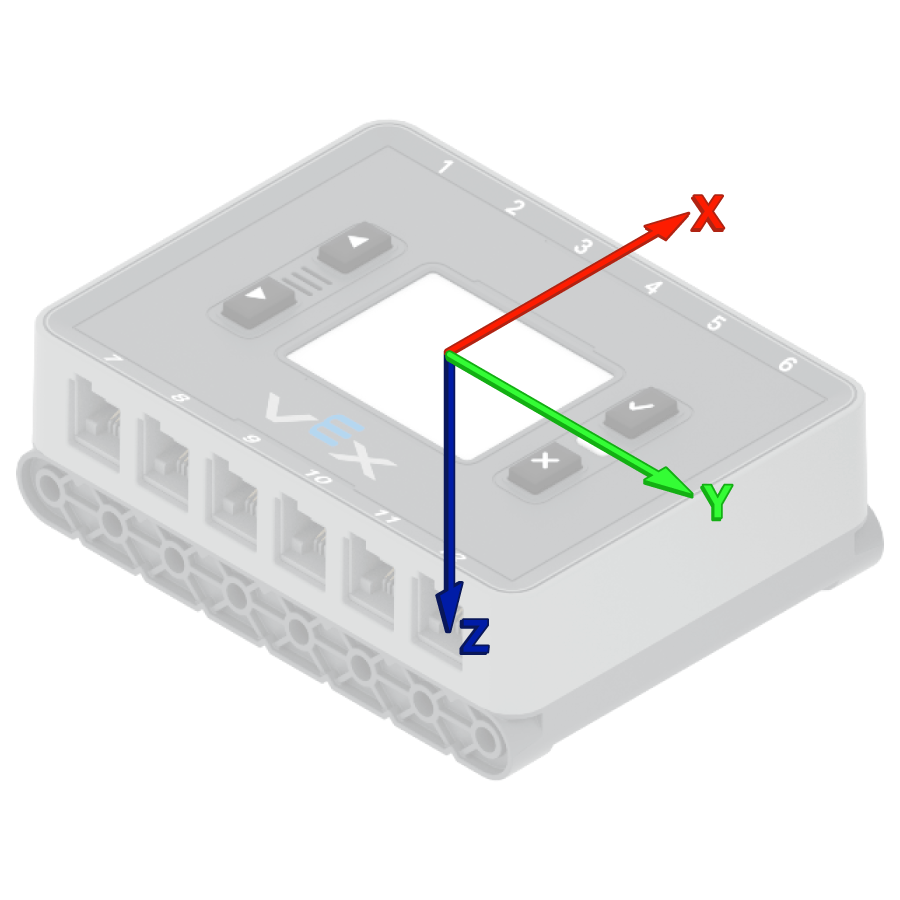

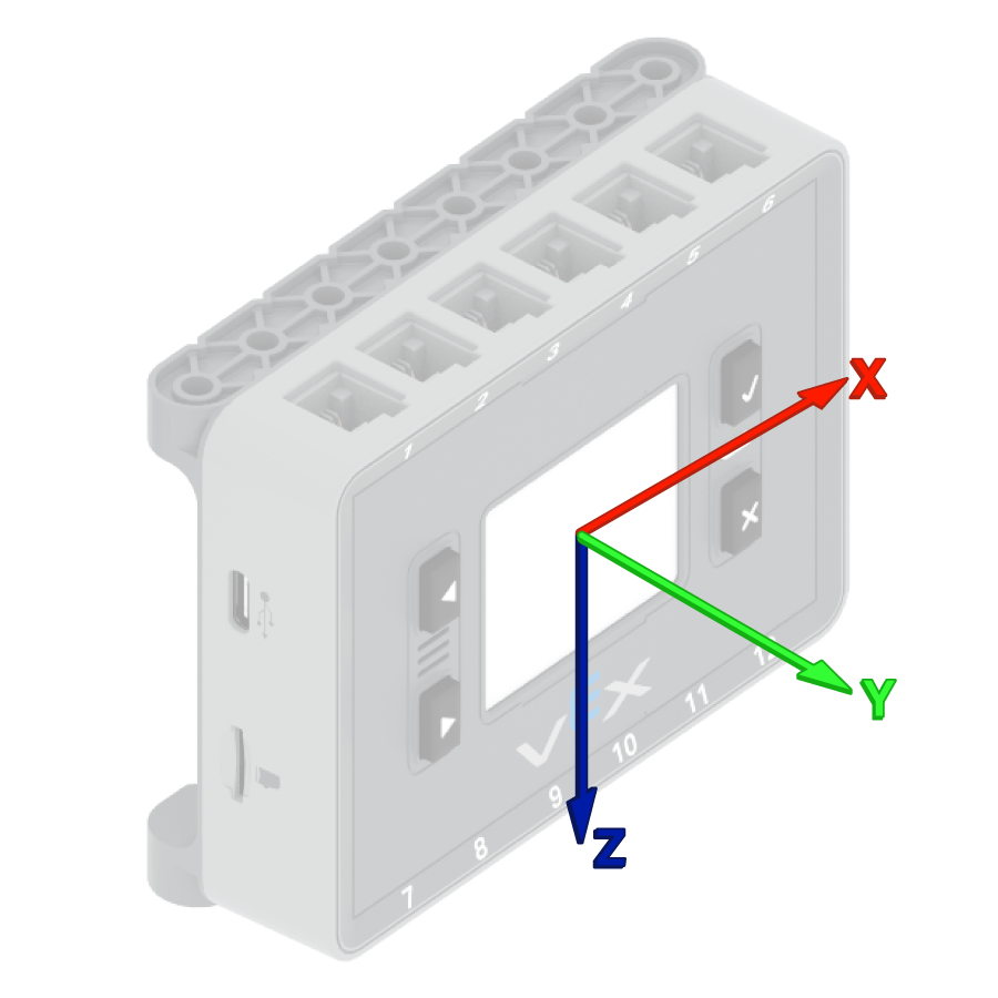

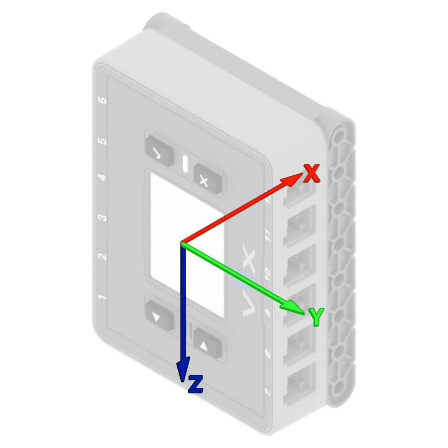

calibrate calibrates the Inertial Sensor. All subsequent lines will wait for calibration to complete before running. Calibration helps the sensor measure turns correctly by measuring and compensating for sensor noise and drift over a specified period. During this time, the Brain must remain completely still on a stable surface. Movement during calibration can produce inaccurate results.
IQ Brain 的屏幕向右倾斜,x、y 和 z 轴分别用从屏幕中心向外延伸的箭头表示。标有 x 的红色箭头指向右侧,标有 y 的绿色箭头向前延伸,标有 z 的蓝色箭头向下延伸。与上一张图片相同的图像,现在大脑屏幕向左倾斜,x、y、z 箭头保持其方向不变。与前一张图相同的图像,现在大脑屏幕朝上,就像平放在一个平面上一样。x、y、z方向相同。
VEX Brain 会在每个项目开始时自动尝试校准内置惯性传感器。但是,如果在项目启动过程中机器人被搬运或移动,传感器可能无法正确校准或校准结果不准确。
