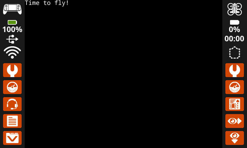

# Display a message at the starting cursor position.
controller.screen.print("Time to fly!")
VEX AIR 无人机控制器屏幕的截图,左上角有白色文字显示“是时候飞行了!”

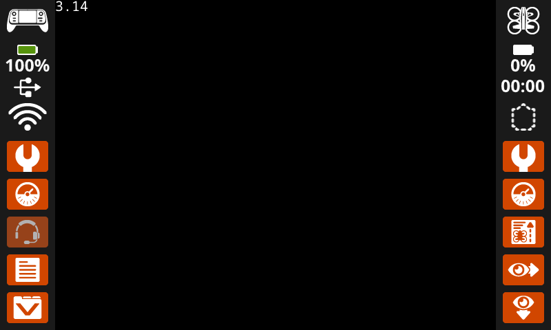

# Display the first 2 decimals of pi
controller.screen.print(3.1415, precision = 2)
与上一张截图相同,左上角文字显示为 3.14。

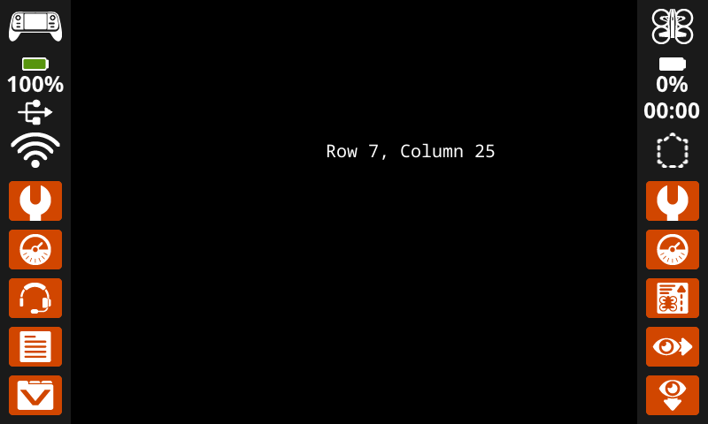

set_cursor#
set_cursor moves the cursor to a specific row and column on the controller screen. The next print call will start printing at that location. The row and column spacing will take into account the selected font. With the default monospaced medium font, the screen can clearly display up to 18 rows and 53 columns. Text placed beyond this range may be cut off or harder to read.
Usage:
controller.screen.set_cursor(row, col)
参数
描述
row
要将光标移动到的行。
column
要将光标移动到的列。
# Display text starting at Row 7 Column 25.
controller.screen.set_cursor(row=7, col=25)
controller.screen.print("Row 7, Column 25")
VEX AIR 无人机控制器屏幕的截图,屏幕中心附近有白色文字,显示“第 7 行,第 25 列”。

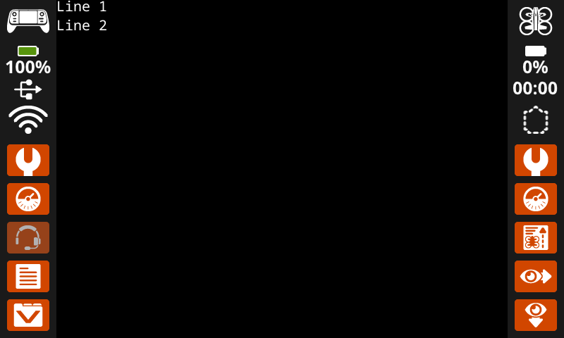

# Display two lines of text.
controller.screen.print("Line 1")
controller.screen.next_row()
controller.screen.print("Line 2")
VEX AIR 无人机控制器屏幕的截图,左上角有白色文字,第一行显示“第 1 行”,第二行紧随其后。

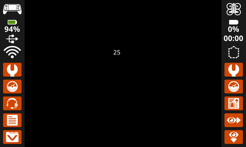

# Display the cursor's current column.
controller.screen.print(controller.screen.get_column())
VEX AIR 无人机控制器屏幕的截图,屏幕中心附近有白色文字“25”,位于第 7 行第 25 列。

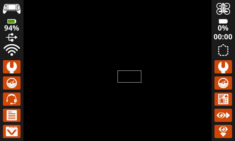

# Set the origin to the center of the screen.
controller.screen.set_origin(x=320, y=240)
# Draw a rectangle at the new origin.
controller.screen.draw_rectangle(x=0, y=0, width=80, height=40)
VEX AIR 无人机控制器屏幕的截图,绘制了一个白色矩形,使左上角位于屏幕中心。

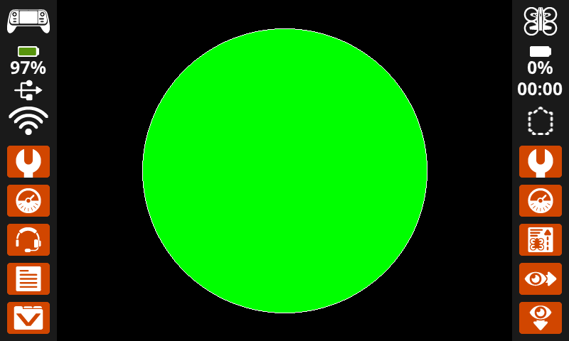

# Draw a circle, and clear it after 2 seconds.
controller.screen.draw_circle(x=320, y=240, radius=80)
wait(2, SECONDS)
controller.screen.clear_screen()

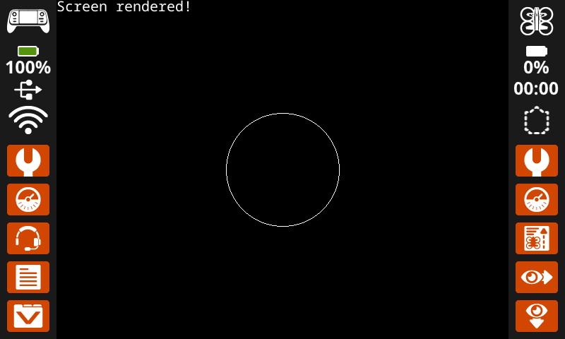

# Display text and images when button 7 is pressed.
controller.screen.wait_for_render()
controller.screen.print("Screen rendered!")
while not controller.button7.pressing():
    wait(5, MSEC)
VEX AIR 无人机控制器屏幕的截图,左上角有白色文字“屏幕渲染完成!”,屏幕中央画有一个白色圆圈。

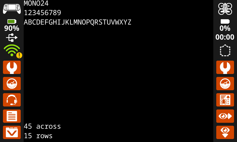

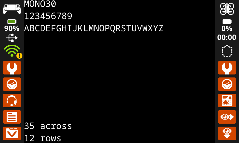

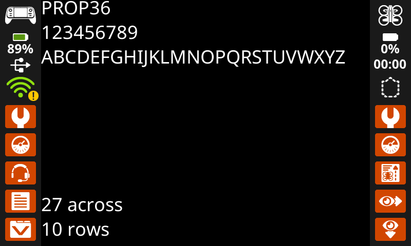

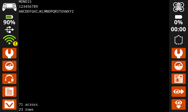

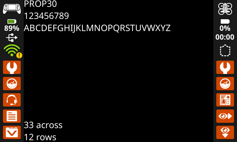

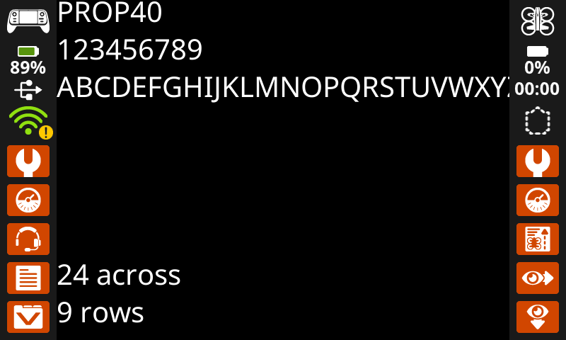

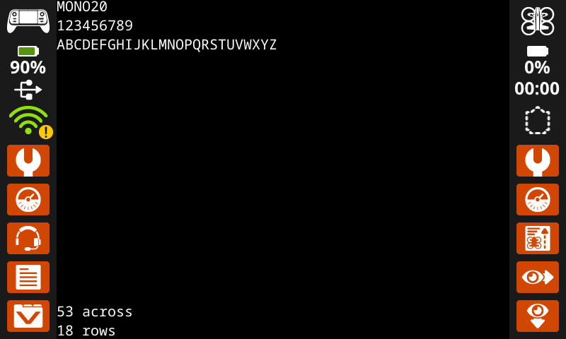

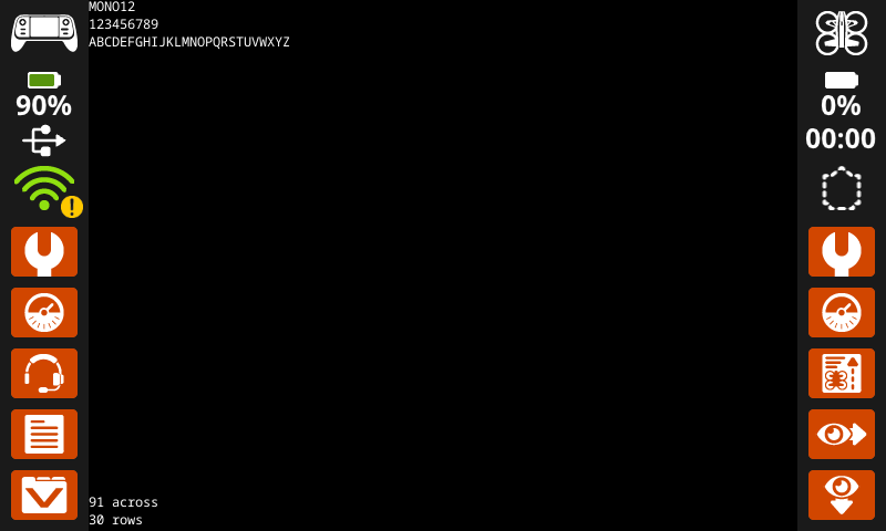

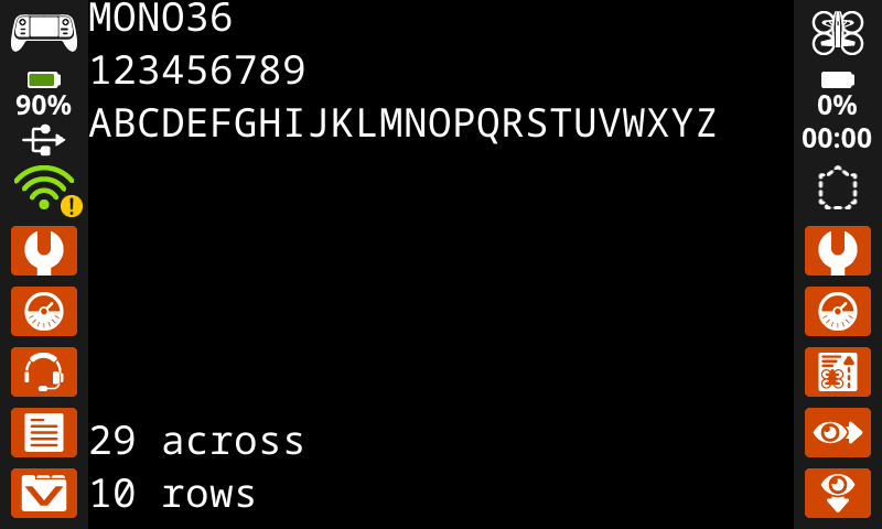

set_font#
set_font sets the font used for displaying text on the controller screen. This font will apply to all text printed after this method runs. The default font at the start of a project is MONO20.
Usage:
controller.screen.set_font(fontname)
范围
描述
fontname
Sets the font to one of the following:
  • MONO12
  • MONO15
  • MONO20
  • MONO24
  • MONO30
  • MONO36
  • MONO40
  • MONO60
  • PROP20
  • PROP24
  • PROP30
  • PROP36
  • PROP40
  • PROP60
这是一张VEX AIR无人机控制器屏幕的截图,左上角用Mono 12字体打印着一些白色字母和数字。字母AZ在一行,占据了屏幕大约三分之一的宽度。左下角显示着91个字符,30行。
MONO12
与上一张图相同,但这次使用了 Mono 15 字体。字母 AZ 位于一行,占据了屏幕近一半的宽度。左下角显示“71 个字符,23 行”。
MONO15
与上一张图相同,但这次使用了 Mono 20 字体。字母 AZ 位于一行,占据屏幕宽度的一半。左下角显示“53 个字符,18 行”。
MONO20
与上一张图相同,但这次使用了 Mono 24 字体。字母 AZ 位于一行,占据屏幕宽度的一半多一点。左下角显示“45 个字符,15 行”。
MONO24
与上一张图相同,但这次使用了 Mono 30 字体。字母 AZ 位于一行,占据了屏幕宽度的大约四分之三。左下角显示“35 个字符,12 行”。
MONO30
与上一张图相同的图像,现在使用了 Mono 36 字体。字母 AZ 位于一行,几乎横跨整个屏幕宽度。左下角显示 29 个字符宽,10 行高。
MONO36

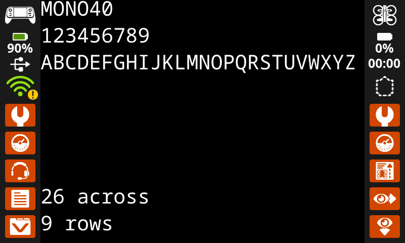

与上一张图相同的图像,现在使用了 Mono 40 字体。字母 AZ 位于一行,横跨屏幕宽度。左下角显示 26 个字符,共 9 行。
MONO40
与上一张图相同,但这次使用了 Mono 60 字体。字母 AQ 位于一行,横跨屏幕宽度。左下角显示 17 个字符,共 6 行。
MONO60

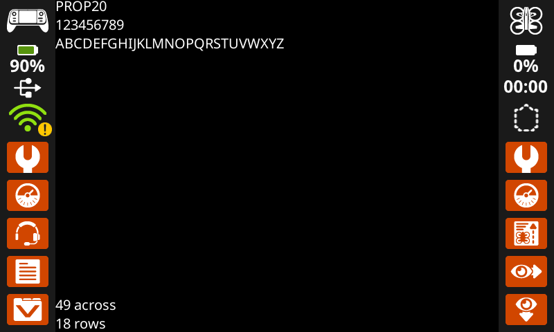

与上一张图相同,但这次使用了 Prop 20 字体。字母 AZ 位于一行,占据了屏幕宽度的一半多一点。左下角显示“49 个字符,18 行”。
PROP20

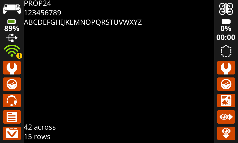

与上一张图相同,但这次使用了24号提案字体。字母AZ在一行,占据了屏幕宽度的大约三分之二。左下角显示“42个字符,15行”。
PROP24
与上一张图相同,但这次使用了 Prop 30 字体。字母 AZ 位于一行,占据了屏幕宽度的四分之三。左下角显示“33 个字符,12 行”。
PROP30
与上一张图相同,但这次使用了36号提案字体。字母AZ位于一行,几乎横跨整个屏幕宽度。左下角显示一行共27个字符,10行。
PROP36
与上一张图相同,但这次使用了 Prop 40 字体。字母 AY 位于一行,横跨屏幕宽度。左下角显示“24 个字符,9 行”。
PROP40

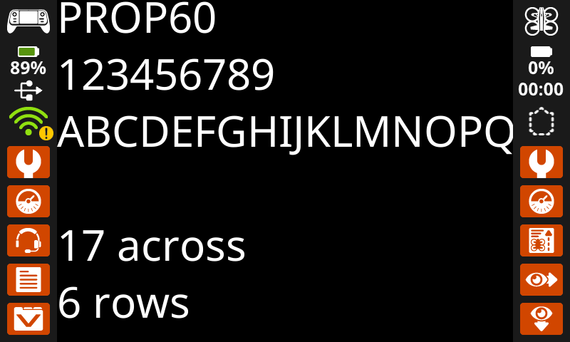

与上一张图相同,但这次使用了 Prop 60 字体。字母 AQ 位于一行,横跨屏幕宽度。左下角显示一行共 17 个字符,6 行。
PROP60
# Display text using a larger font.
controller.screen.set_font(MONO40)
controller.screen.print("VEX")
与之前的图片相同,现在左上角印有 Mono 40 字体的 VEX 字样。

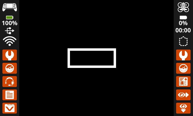

# Draw a rectangle with a pen width of 10.
controller.screen.set_pen_width(10)
controller.screen.draw_rectangle(x=200, y=200, width=200, height=80)
VEX AIR 无人机控制器屏幕的截图,中间印有一个带粗边框的白色矩形。

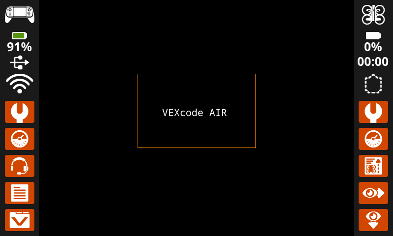

set_pen_color#
set_pen_color sets the color of text, pixels, lines, and shape outlines.
Usage:
controller.screen.set_pen_color(color)
范围
描述
color
Optional. Sets the pen and font color. Options include:
  • BLACK
  • BLUE
  • CYAN
  • GREEN
  • ORANGE
  • PURPLE
  • RED
  • TRANSPARENT
  • WHITE
  • YELLOW
You can also specify a custom color.
# Draw a rectangle with an orange outline.
controller.screen.set_pen_color(ORANGE)
controller.screen.draw_rectangle(x=200, y=150, width=240, height=150)
controller.screen.set_pen_color(WHITE)
controller.screen.print_at("VEXcode AIR", x=250, y=220)
VEX AIR 无人机控制器屏幕的截图,中间有一个细长的橙色矩形,矩形内印有白色的“VEXcode AIR”字样。

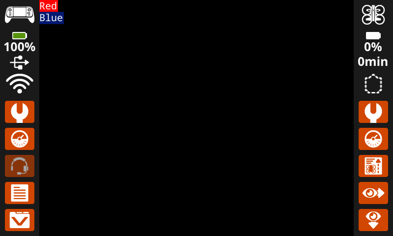

# Display two colors behind text
controller.screen.set_text_fill_color(RED)
controller.screen.print("Red")
controller.screen.set_text_fill_color(BLUE)
controller.screen.print("Blue")
VEX AIR 无人机控制器屏幕的截图,左上角打印了两行文字。第一行是白色字体的“红色”,并以红色高亮显示;第二行紧随其后,是白色字体的“蓝色”,并以蓝色高亮显示。

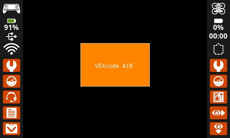

set_fill_color#
set_fill_color sets the fill color used when shapes are drawn. The default fill color is black.
Usage:
controller.screen.set_fill_color(color)
范围
描述
color
Optional. Sets the fill color. Options include:
  • BLACK
  • BLUE
  • CYAN
  • GREEN
  • ORANGE
  • PURPLE
  • RED
  • TRANSPARENT
  • WHITE
  • YELLOW
# Draw an orange-filled rectangle with text on top
controller.screen.set_fill_color(ORANGE)
controller.screen.draw_rectangle(x=200, y=150, width=250, height=150)
VEX AIR 无人机控制器屏幕的截图,图中有一个实心橙色矩形,四周有细细的白色边框,矩形中央印有白色文字“VEXcode AIR”。

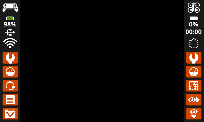

# Draw five pixels in a diagonal.
controller.screen.draw_pixel(x=360, y=200)
controller.screen.draw_pixel(x=340, y=220)
controller.screen.draw_pixel(x=320, y=240)
controller.screen.draw_pixel(x=300, y=260)
controller.screen.draw_pixel(x=280, y=280)
VEX AIR 无人机控制器屏幕的截图,屏幕中央沿对角线均匀地印有 5 个像素。

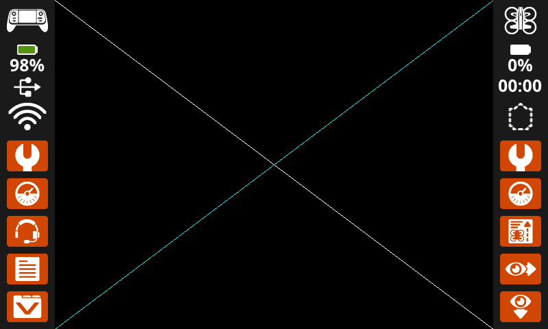

# Make an X across the screen.
controller.screen.draw_line(x1=0, y1=0, x2=640, y2=480)
controller.screen.set_pen_color(CYAN)
controller.screen.draw_line(x1=0, y1=480, x2=640, y2=0)
VEX AIR 无人机控制器屏幕的截图,从左上角到右下角画一条白线,从左下角到右上角画一条青色线,两条线在中心相交。

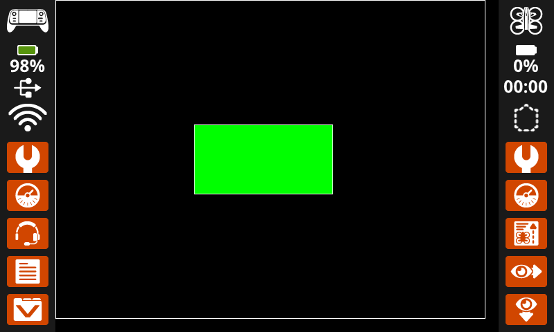

# Draw two rectangles on the screen.
controller.screen.draw_rectangle(x=0, y=0, width=620, height=460)
controller.screen.draw_rectangle(x=200, y=180, width=200, height=100, color=GREEN)
VEX AIR 无人机控制器屏幕的截图,屏幕中心印有一个带有细白边框的实心绿色矩形,屏幕外缘印有一个细白边框。

# Draw one green circle on the screen.
controller.screen.set_fill_color(GREEN)
controller.screen.draw_circle(x=320, y=240, radius=200, color=GREEN)
VEX AIR 无人机控制器屏幕的截图,屏幕中央绘制了一个带有细白边框的大型实心绿色圆圈。
