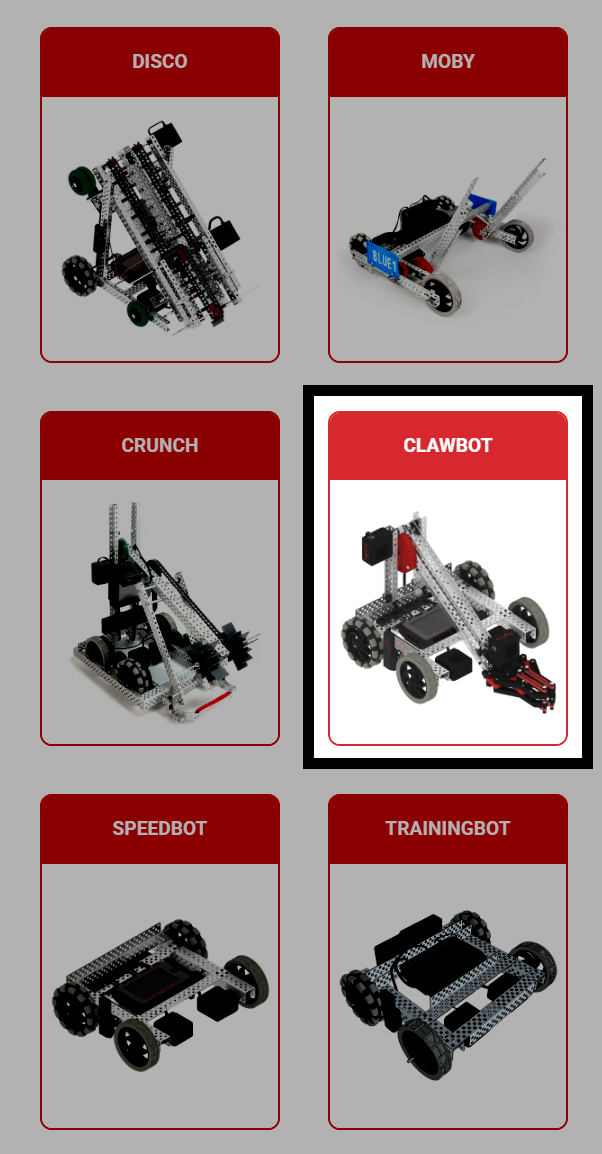

Select the Clawbot Build#
Select the Clawbot build.

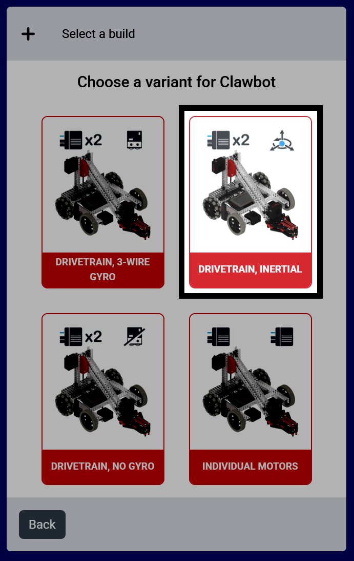

Choose the Drivetrain Variant#
The build used for this tutorial is the Drivetrain, Inertial version of the Clawbot, which includes both a Claw and an Arm motor.

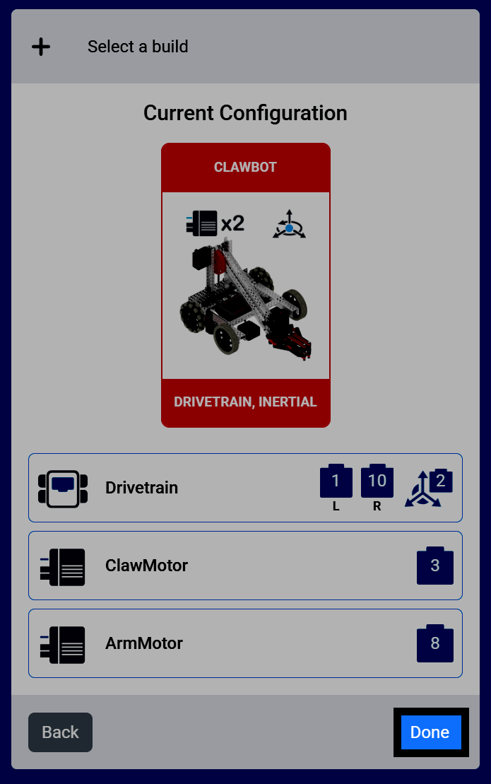

Confirm the Configuration#
Select Done to add this build to your project.

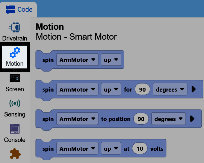

Open the Motion Category#
Select the Motion category in the toolbox to find the spin blocks.
Attach the Spin Block#
Attach the spin motor for block to the when started block.
spin [ArmMotor v] [up v] for (90) [degrees v] ▶
