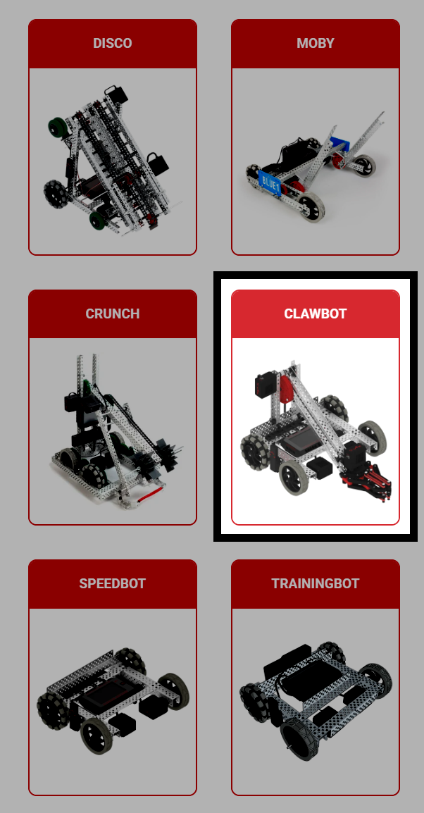

Select the Clawbot Build#
Select the Clawbot build.
Screenshot of the Select a build screen, with the Clawbot build highlighted among other robot builds.

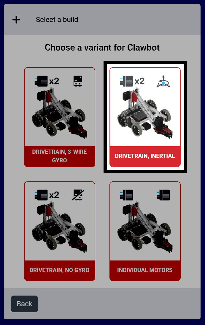

Choose the Drivetrain Variant#
The build used for this tutorial is the Drivetrain, Inertial version of the Clawbot, which includes both a Claw and an Arm motor.
Screenshot of the Choose a variant for Clawbot screen, with the Drivetrain, Inertial variant highlighted among the Drivetrain, 3-Wire Gyro, Drivetrain, No Gyro, and Individual Motors options.

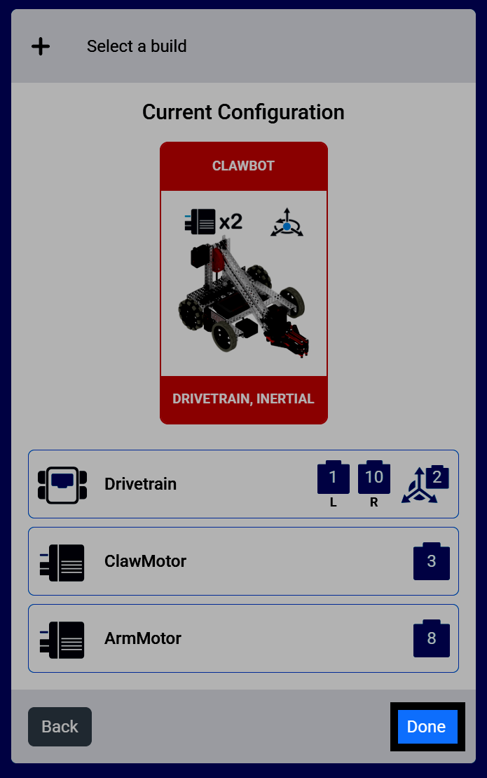

Confirm the Configuration#
Select Done to add this build to your project.
Screenshot of the Current Configuration screen for the Clawbot, Drivetrain, Inertial build, showing the Drivetrain, ClawMotor, and ArmMotor devices, with the Done button highlighted.

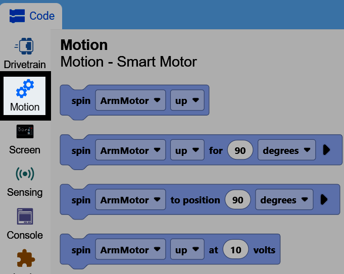

Open the Motion Category#
Select the Motion category in the toolbox to find the spin blocks.
Screenshot of the toolbox with the Motion category open, showing the spin ArmMotor blocks.
