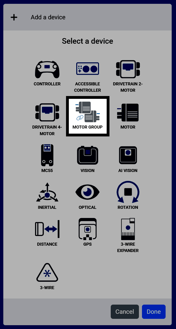

Select Motor Group#
If your robot uses multiple motors that all work together at the same time to move a part of the robot, select Motor Group instead.
Screenshot of the Select a device screen, with Motor Group highlighted.

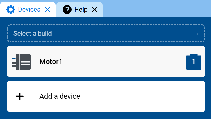

View the Motor in Your Devices List#
The Motor or Motor Group will now appear in your list of devices, and its blocks will be added to your toolbox.
Screenshot of the Devices tab, showing Motor1 in the list of devices.
