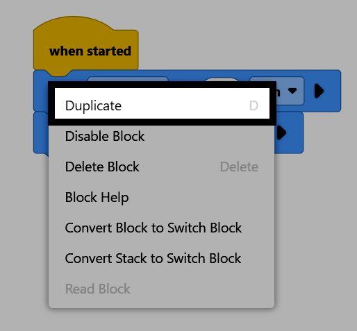

If you want your robot to repeat the same action multiple times, like driving in a square, you could right-click the blocks and select Duplicate from the context menu, and keep duplicating those blocks until they move in the pattern of a square. A simpler way, however, is to use the repeat block within the Logic - Control category.
Right-click a block to open its context menu.
Screenshot of a block's right-click context menu, with Duplicate highlighted.

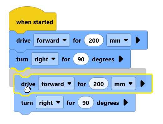

Select Duplicate to make a copy of the block, and any blocks connected below it. Repeat this until the blocks are duplicated as many times as you need.
Screenshot of a duplicated drive for and turn for block being dragged below the original blocks.

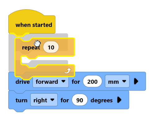

Connect the repeat block to the when started block.
Screenshot of a repeat block being connected below a when started block.

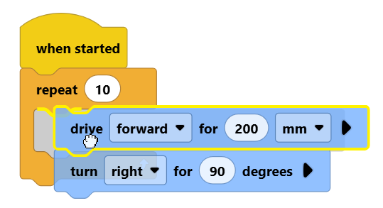

Drag the drive for and turn for blocks inside of the repeat block.
Screenshot of a drive for block being dragged inside of a repeat block.
