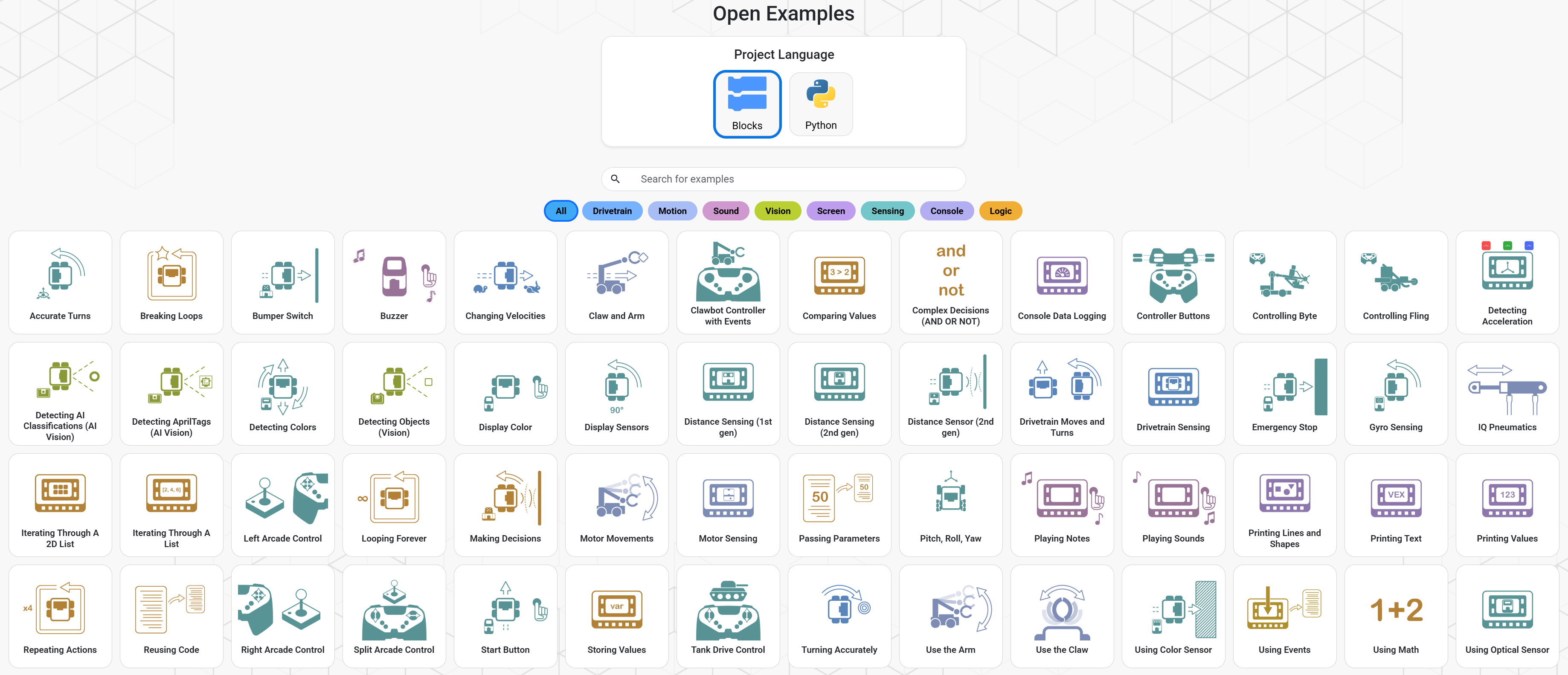

  1. The Open Examples page shows all the available example projects.
Screenshot of the Open Examples page, showing the Project Language options and a grid of example projects with category filters.

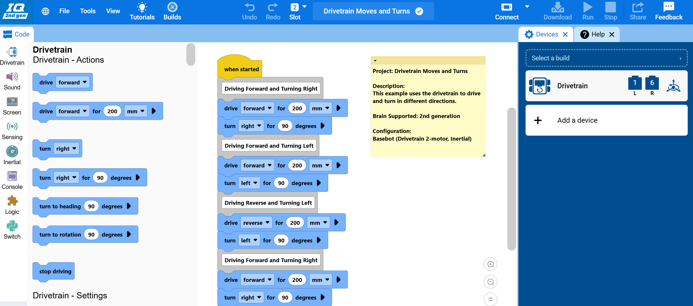

  1. The project will open in VEXcode with code demonstrating the example already in the workspace. The robot will already be configured in the Devices menu, and a note in the workspace will explain what the project does and what device configuration to use with it.
Screenshot of an opened example project in VEXcode, showing the example's blocks in the workspace and a comment explaining the project.

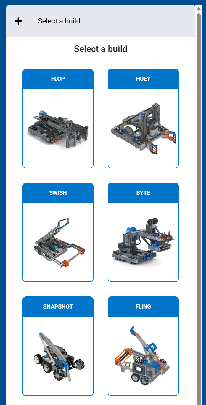

  1. Select the robot build you are using.
Screenshot of the Select a build screen, showing a grid of available robot builds.

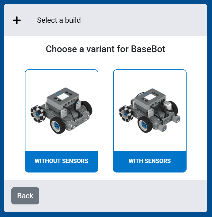

  1. If your build has different versions, select which version you’re using.
Screenshot of the Select a build screen, showing the Without Sensors and With Sensors variant options for the BaseBot build.

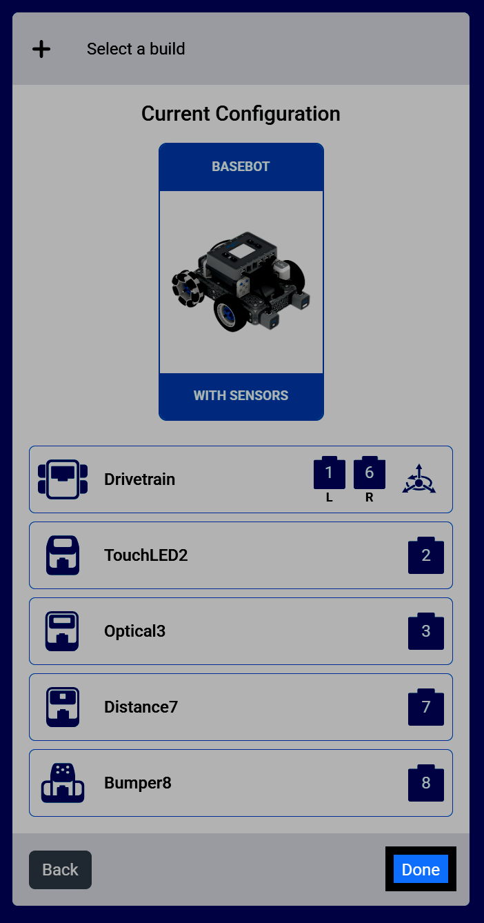

  1. VEXcode will show you all of the devices used with the build and what ports they’re connected to. Select Done to add this configuration to your project.
Screenshot of the Current Configuration screen, showing the build's devices and the Done button highlighted.

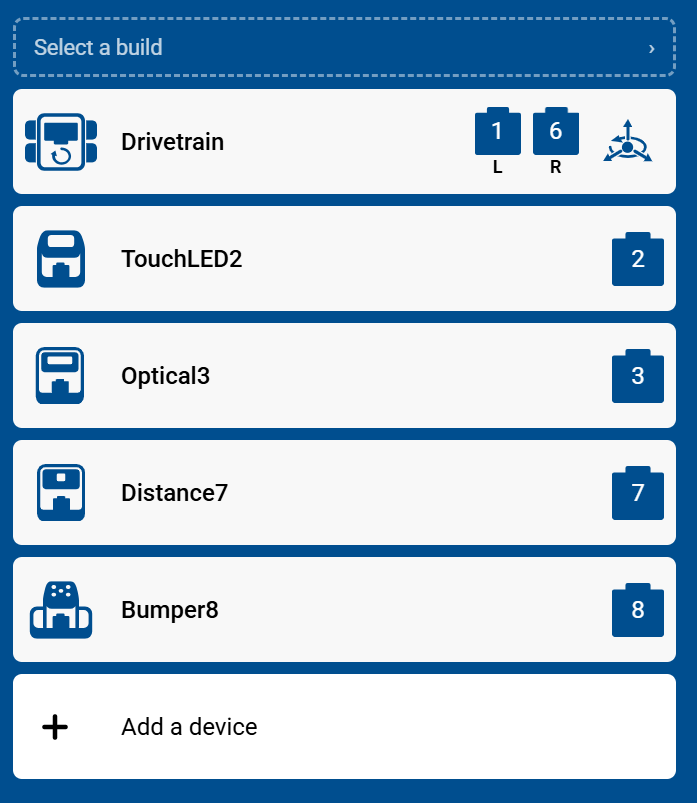

  1. Those devices will now appear, configured in the Devices menu, ready to code with.
Screenshot of the Devices tab, showing the Drivetrain, TouchLED2, Optical3, Distance7, and Bumper8 devices added from the build.
