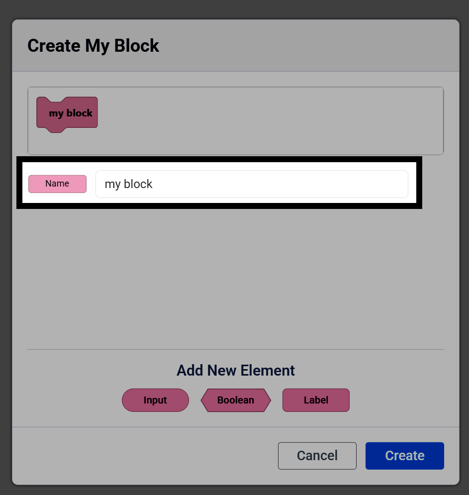

Change the name of your My Block.
Screenshot of the Create My Block dialog, with the Name field highlighted.

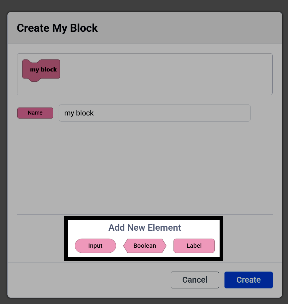

Select an element to add to the block:
  • Input provides a place to enter text or numbers.
  • Boolean provides a place for a true or false value.
  • Label lets you add text to the My Block for organization.
Screenshot of the Create My Block dialog, with the Add New Element row highlighted, showing Input, Boolean, and Label options.

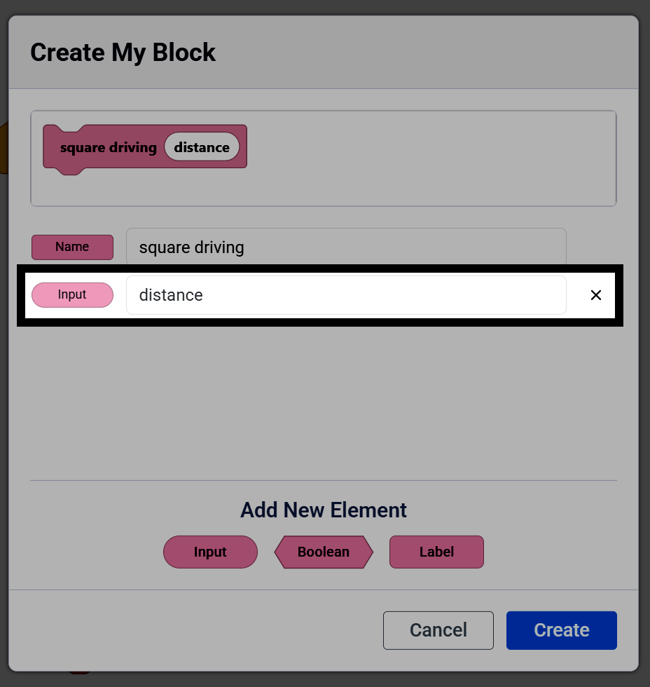

Changing an element’s name changes the name of that My Block parameter. It does not change how the My Block functions.
Screenshot of the Create My Block dialog, with an Input element named distance highlighted.

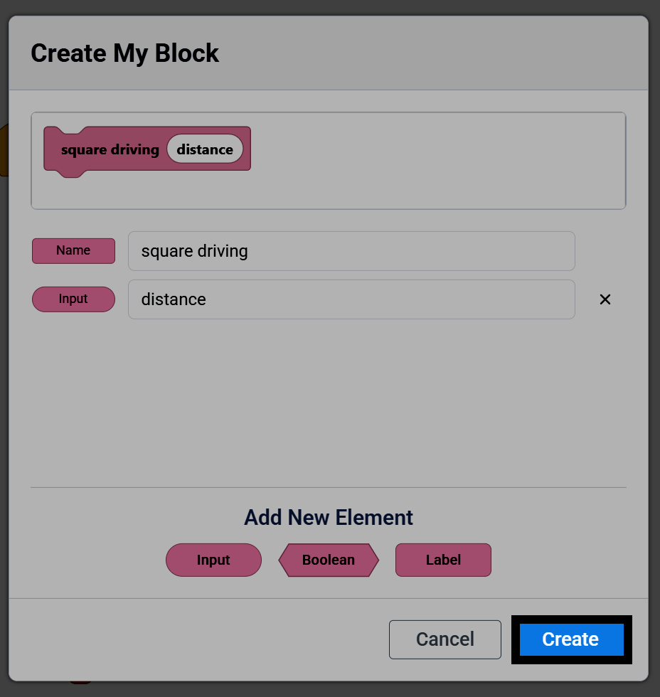

Once you’re done setting up your My Block, select Create.
Screenshot of the Create My Block dialog, with the Create button highlighted.

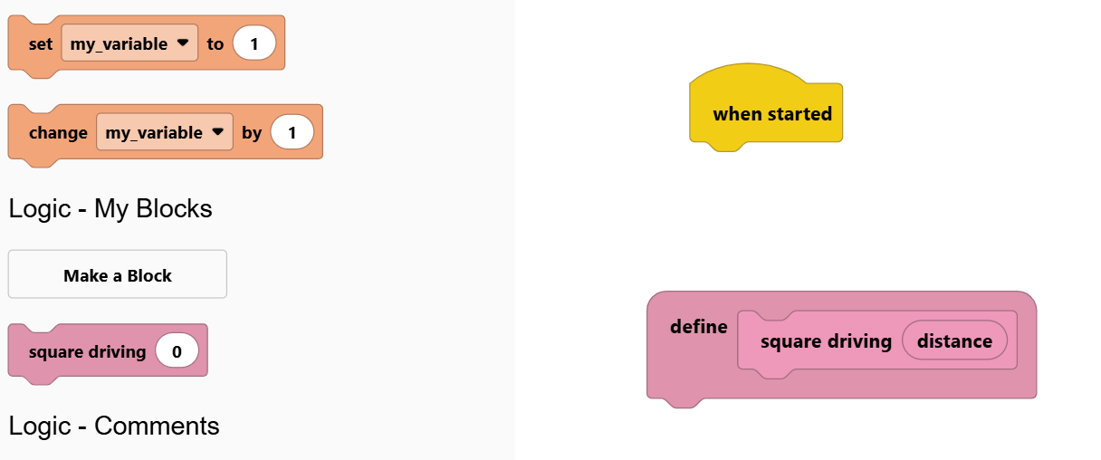

A define hat block for your My Block will appear in the workspace, and the My Block will appear in the toolbox. Attach blocks below the define block — any blocks attached will run when the My Block is used in the project.
Screenshot of the workspace with a define square driving distance block, and the new square driving block now shown in the toolbox.

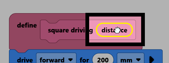

To use a parameter from your My Block, select it on the define block and drag it out to create a usable reporter or Boolean block.
Screenshot of the distance parameter being dragged out of a define square driving block.
Drop the parameter into another block’s input to use its value. That parameter can only be used within the My Block’s own stack of blocks.

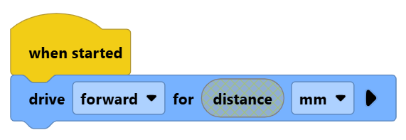

If you try to use a My Block’s reporter or Boolean block outside of that My Block’s own stack of blocks, it will be grayed out to show that it will not work.
Screenshot of a when started script using a drive for block with the distance parameter grayed out, since it is used outside of the My Block that defines it.
