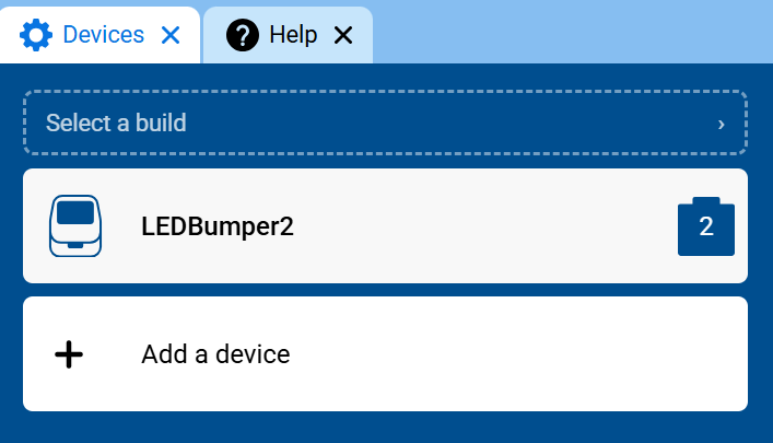

Make sure your robot has an LED Bumper connected. See Configuring Devices if you haven’t added one yet.

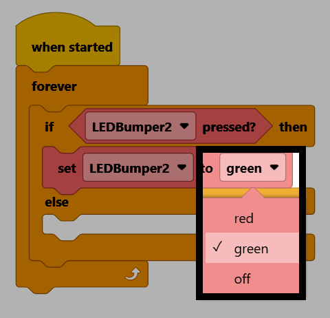

In the if branch, attach a Set Bumper color block.
when started :: hat events
forever
if <[LEDBumper2 v] pressed? :: custom-led> then
set [LEDBumper2 v] to [red v] :: custom-led
else
end
end

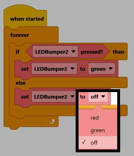

Change the color parameter to green.
In the else branch, attach another Set Bumper color block.
forever
set [LEDBumper2 v] to [green v] :: custom-led
else
end
end
Change the color parameter to off.
Make sure your robot is connected to VEXcode. See Connecting to Your Robot if it isn’t connected yet.
Select Start to run the project, then press the LED Bumper. It will light up green while pressed, and turn off when released.
