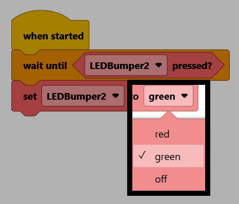

Attach a Set Bumper color block below the wait until block.
when started :: hat events
wait until <[LEDBumper2 v] pressed? :: custom-led>
set [LEDBumper2 v] to [red v] :: custom-led
Change the color parameter to green.
Make sure your robot is connected to VEXcode. See Connecting to Your Robot if it isn’t connected yet.
Select Start to run the project.
Press the LED Bumper to turn the bumper green.
