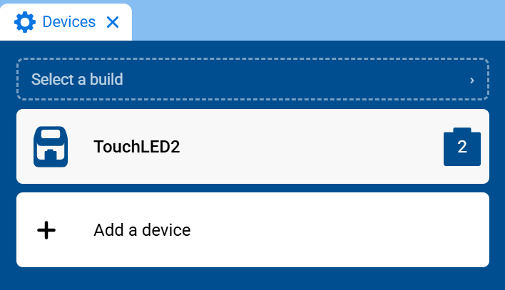

  1. The Touch LED will now appear in your list of devices, and its blocks will be added to your toolbox.
Screenshot of the Devices tab, showing TouchLED2 in the list of devices.
